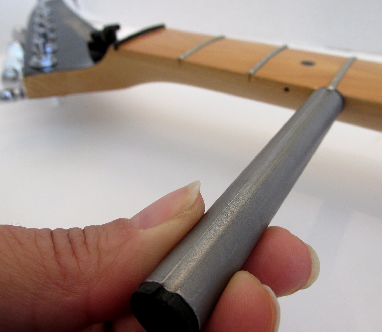

          One more gadget I just HAD to buy- a 90/35 degree fret end tool...
          Nifty!
                G M I Fret End Beveling Flushing Files 35 Degrees and 90 Degrees Luthier Tool | eBay
                I heard that sharpening stones work great, too, but I want that angle to be exact. I would normally choke on a $14 shipping charge on a $34 product but it did come all of the way from Greece...
                I suspect that this is an original design from G.M.I. since it is not available anywhere else.
                Steve A.
                I use an older stew-mac version of this, but it doesn't have the 90° file. They are very useful.

                        So for bullet fret ends file them at a 35 degree angle after leveling the frets and then during the crowning process crown the ends of the frets as well as the tops. You can do it in one motion curving the tool around when you reach the end of the fret.
                        You don't need the GMI file but one thing really cool about it is that you can use it for all of the frets on a set neck guitar. The file goes to the very end of the block and doesn't stick out much (.220") so it doesn't scratch the top of the guitar.
