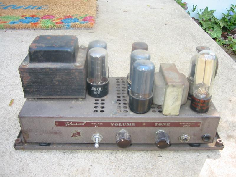

Locating the EF86 socket close to the input jack will allow short wires to be used. I suggest using terminal strips as opposed to an eyelet board. Solder components between the tube socket pins and terminal strips when possible. Keep all wires short. Do you have any pictures of the chassis?

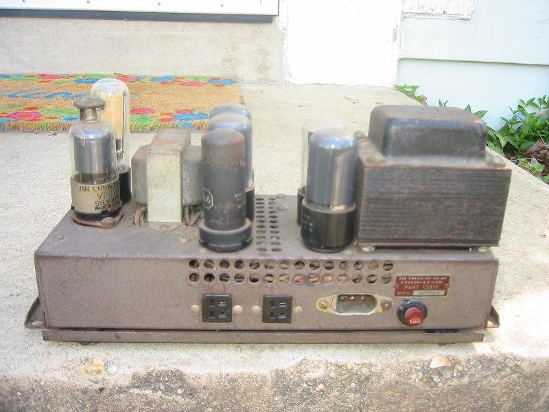

pics of chassis
these are pics i grabbed off the web, so not the actual amp i'm dealing with but the same model:
http://www.scottmcknight.com/FOSX1.JPG
http://www.scottmcknight.com/FOSX2.JPG
The inside is a rat's nest of course, one reason I'd like to gut it. But there won't be a great deal of room regardless. The chassis is about 10" long, 5" wide and MAYBE 2" deep.

What are the two tubes on the end farthest from the PT? I would strip those out and install the EF86 socket there close to the microphone jack.
I can see that one of the tubes right next to the PT is a 5Y3, is the other one a 6V6? I can see one metal 6V6 towards the back, where's the other one?

tube config, original schematic
You're correct, 2 6v6's and a 6sL7 all in a row. Then a 6v6 as an oscillator along with a 5y3 closest to the power tranny. Actually that 6v6 may be one of the power tubes and one of the others the oscillator, which doesn't really matter once the wiring's gone.
Then next to the output transformer on the far end, situated above the original 1/4" input jack, are a photo tube and a 6J7. The schematic for the original amp is here:
