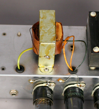

The OT has to have a "return" somewhere that goes to ground. The old layout only shows one wire because the other wire was soldered directly to the OT casing, which is then grounded to the chassis by virtue of it being screwed to it. As below:
What kind of OT do you have? There should be a second ("return") output wire somewhere. I suppose it's possible it's connected to the casing internally. In which case, if you take a continuity tester (or ohmmeter) and measure from the one output lead you have to the casing or, better, to the amp chassis you should get a "beep" or a very low resistance reading.
The type of output jacks you have look like their "rings" should already be grounded to the chassis by being bolted to it.

Mine is like the one in the picture...the one I bought is Mercury Magnetics. So I guess it's already grounded.
