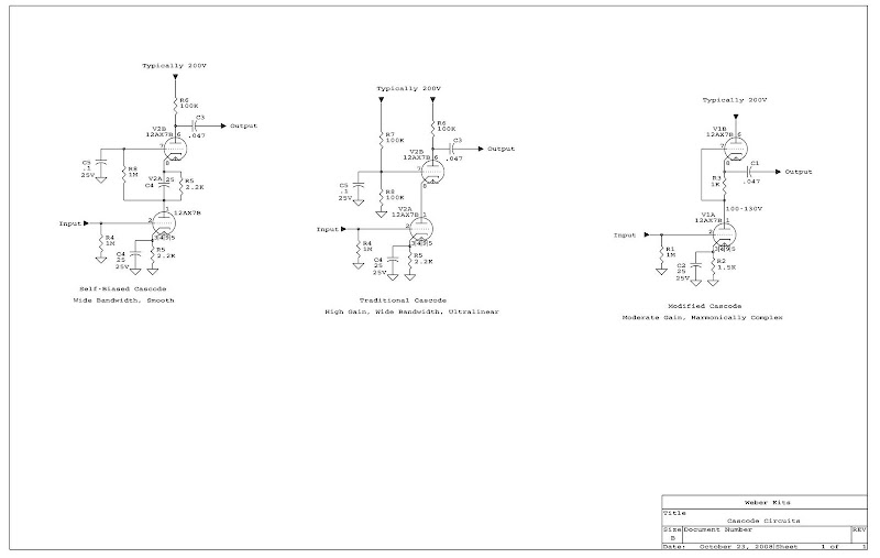

cascode ideas from Ted Weber (RIP)
C Ted Weber
