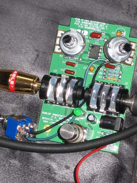

    Here is just a simple mod you can do for fun. I added a switch to toggle between diodes - Silicon/Germanium. To be honest, there isn't a huge difference. I might swap one side out for LEDs.

    I did the Si/Ge mod and find that it makes a substantial difference, especially with respect to output level. The Si diodes will provide approximately double the maximum output level.
