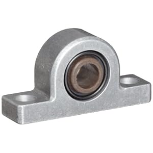

                Go find an old sewing machine ($15-20) and rob the stuff, like I did. You can make your own arbor from a couple of pillow blocks ($20) and some 3/8 steel rod ($2).
                Check out ebay for pulleys, about $4. A handful of 3/8 collars and a little thought, you'll have a smooth running arbor in about an hour. Hook up the sewing machine motor and step on the gas.
                Most of this is stuff you can find at a real hardware store, not Lowes or Home Depot, but a real one. It's a really simple setup that is easy to control and get spinning with. You can grow into a CNC machine from their. I'd say wind a few with a simple machine and see how you like the results. You're going to end up building several winders, just like you're gonna build several guitars. With both, each will be better, and you can rob parts off the old ones to build new ones. You just need to get past the planning phase and onto the doing it phase. It falls in place as you go. You could have a winder up and running by the end of the day, if you had the sewing machine in hand, even on a Sunday. The rest is waiting at the hardware store.
