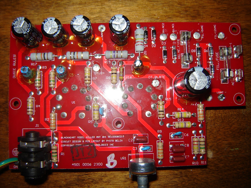

Looking at the schematic, the first 2 triode stages (the preamp tube, V1A and V1B) are pretty typical. 100K anode resistors, 1.5K cathode resistors bypassed with 1uf caps, with a Marshall 'esq volume/gain dump/tone shaping circuit between them. Following the gain stages is a cathode follower (V2A), which my reading told me was a stage that had no gain of its own, and is used only to match impedance with a heavy load that follows it, usually a tone stack. That didn't make much sense to me, because there is no tone control at all, let alone one that had a high enough insertion loss to warrant the waste of a 1 of only 4 triodes on a no gain cathode follower!
But looking after the cathode follower stage, marshall fans will see something familiar. It's a full on treble/middle/bass tone stack, but instead of pots, it just has fixed resistors with values chosen to replicate a marshall tone stack with everything at 10! So at least the cathode follower makes sense now, even though the whole idea of wasting a triode to drive a non-adjustable tone stack seems pretty stupid.
After the tone stack comes the power amp section, which is a single ended class A using the other triode in the cathode follower tube. So really it's not one preamp tube and one power amp tube, it's 3 triode preamp and 1 triode power amp. That makes it a little tricky swapping out V2 with something other than a 12AX7, because the cathode follower was designed to use a 12AX7, and using a lower gain 12AU7/Y7/T7 might allow the tone stack to haul down the signal a lot.

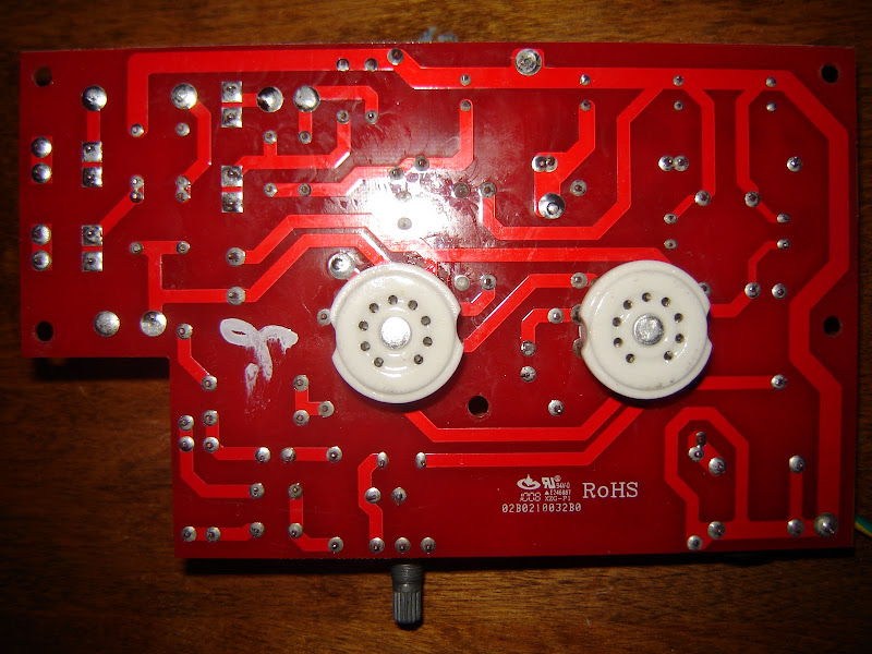

The power amp section took me a while to figure out what was going on, especially the network of resistors before the grid, R13, 14 and 15. I figured out R15 was a grid stopper, used to block radio transmissions, but the 100K value seems very high. I though R14 might be a grid leak, but then it dawned on my while I was think how dumb a non-adjustable tone stack was. R13 and 14 form a voltage divider, which is basically a master volume control, but again, non-adjustable with fixed resistors. Not only that, but the values chosen (470 Ohm each) replicate a 1M audio taper pot tuned up to about 7. So they're robbing us of the last juicy bit of overdrive, presumably because the stock tubes just sound like azz driven that hard. Bummer because the 12AU7 or 12AT7 would probably sound great with it "at 10".
