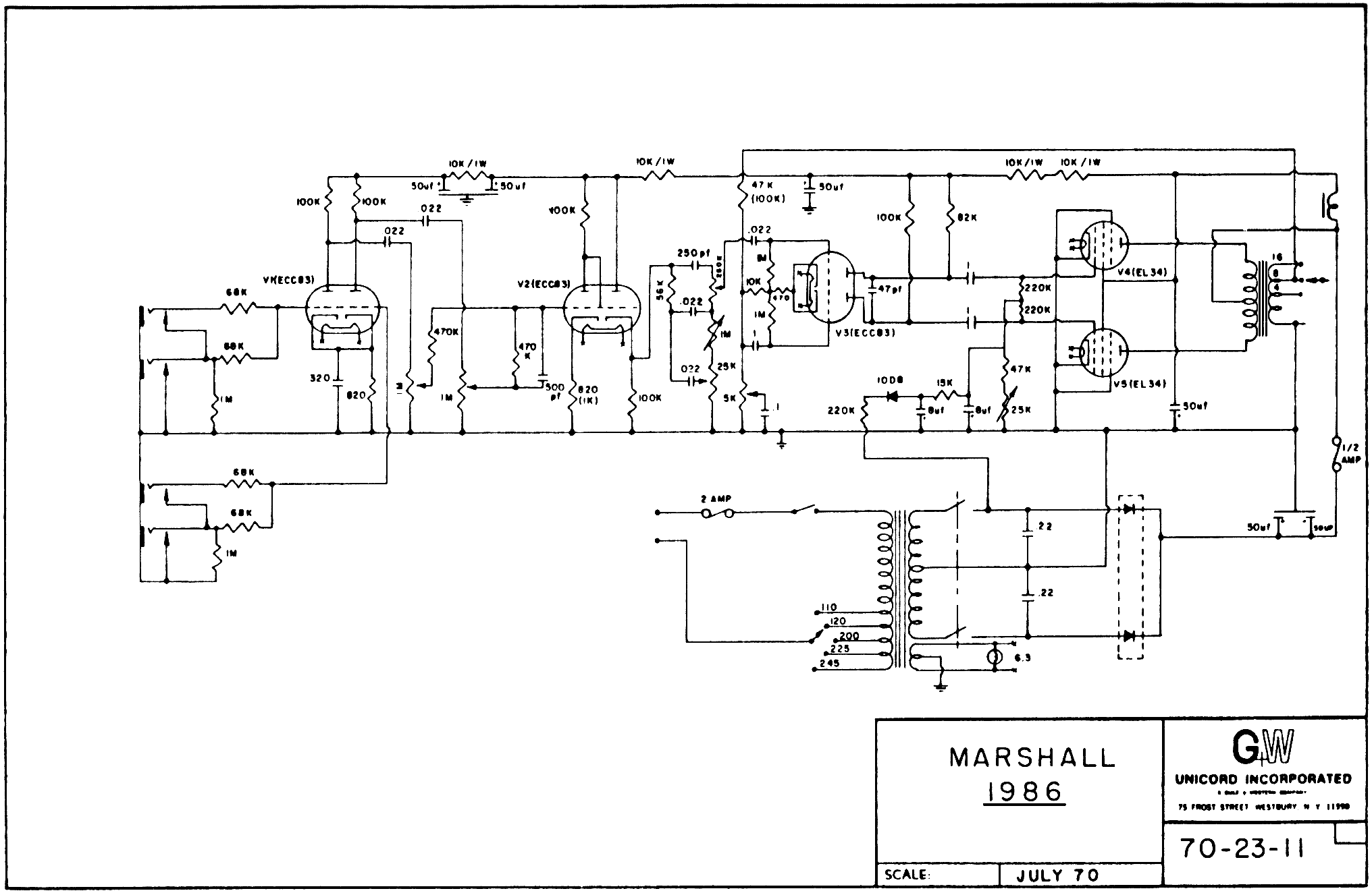

    So I'm looking at a PT That has separate taps for 280-0-280, 312.5-0-321.5, and 345-0-345 supply levels. Would placing all these taps on a selector switch throw off the bias too much to be practical? It's gonna be an EL34 50W Plexi style circuit. Any other concerns come to mind?

        I don't see a bias tap on that transformer. Where do you plan on getting your fixed bias AC from?
        Valvulados
          Complete the bridge to make a high voltage negative supply, and drop it down with a resistor divider. This takes very little current
            Sounds like a Marshall alright
            Valvulados
              Plexi doesn't usually have a bias tap anyway.
              http://www.drtube.com/schematics/marshall/1986u.gif
              Was also considering using a dual 250k pot as an MV in place of the 220k resistors. Did this recently with an AC15 but it doesn't use a bias supply like that, the 220k's just go to ground. Is adding the MV going to cause me problems in the bias?

                I wouldn't use that kind of MV on a fixed bias amp. First you don't want DC on your pots, second because a pot failure means bias failure and melting EL34's and possibly a OT replacement.

                    Yeah, placing the MV on the power tube grids is not uncommon, other amps do it in various ways. E.g. Orange Tiny Terror also does it, but it's self biased.
                    IMO it's not a good idea for fixed bias amps.
                    The Rich Mod works by cancelling the inverted signals through common mode rejection. At zero volume it shorts the two grids, since the tubes are in push pull they cancel out. This kind of MV never fully zeroes the volume unless the inverter sections and power tubes are fully matched. This rarely ever happens in guitar amps so you end up with some audio leakage.
                    The risk of shorting the bias to ground is lesser in that configuration, but again you know Murphy's Law I wouldn't put any movable parts near the bias supply unless necessary.

                            To jump back to the B+ options, is it probably not going to change the bias enough to either sound bad or be too hard on the output tubes? Will I likely be able to find a happy medium by adjusting the bias so that the lower B+ setting would run the tubes slightly hot on current, the mid B+ setting hit right in the middle, and then the hi B+ setting run a little lean on current? Am I thinking about this in the right way... (?)

                              Every master volume architecture has drawbacks. And every kind of master volume kills some tone in some way. So much so some purists never use master volumes in their boutique amps.
                              So the first question is do you really need a master volume? What kind of music do you plan on playing? A lot of the distortion is fed into the preamp from effects pedals these days, so if you plan on doing a lot of the tone and distortion shaping via pedals then you don't really need a master volume. I rarely see a musician using the master volume as it was designed to be used anyway.
                              If you do want a MV, the simplest and most fail-safe one is this: http://www.drtube.com/schematics/marshall/2204u.gif
                              A 1M log pot working as a voltage divider right before the coupling cap going into the phase inverter. That's the Marshall recipe right there and it never fails.
