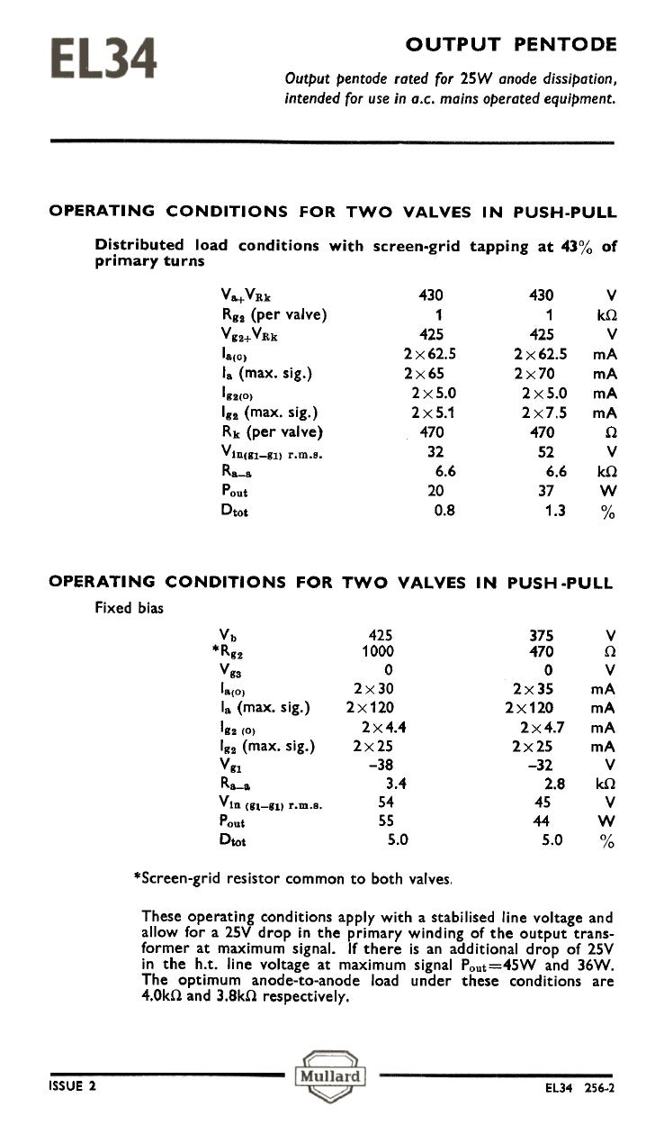

What i'm asking in the title is, does anyone know why the origin 20 watt amp has 20 watts with 2 El34's vs the origin 50 watter with the same pair of EL34s? Small iron or low plate V ? Just curious....

Low volts, cathode bias... And because everyone is a sissy nowadays and a 22W Deluxe Reverb os "too loud & you're drowning every one out & & & wha wha wha!" So 20W is 2 less, innit?

The amp output power depends on the working class amp (A, AB, B), anode voltage and load resistance (Raa)
https://www.slideshare.net/ValveData/valve-amplifier-design-el34-6ca7-data-mullard-valves
https://image.slidesharecdn.com/el34-120607235944-phpapp02/95/valve-amplifier-design-el34-6ca7-data-mullard-valves-2-728.jpg?cb=1339113885
Here it is best to see how at the same anode voltage, the output power changes depending on the class of work in which the amplifier works and the load ressistance (Raa)
If anode voltage and load ressistance (Raa) is known, it is easy to determine the output power.
Load ressistance (Raa) is calculated by measuring ratio output transformer.
