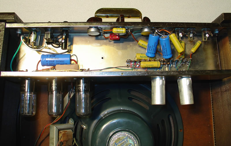

                    Rick write the Ga-6 lancer have grid leak bias, but at this schematic it have cathode bias input:
                    http://www.schematicheaven.com/gibso...ga6_lancer.pdf
                    And he put the 5E3 down because cone cry and ghost notes,. Aint that speaker issues?
                    • #25
                      Well, he put down the 5E3 for harp use, it sounded great with a Strat.
                      Yes, cone cry and ghost noting could be speaker issues. What we were hearing was the ghost noting with hard reed bending.
                      The speaker in the 5E3 was also a real late 50's Jensen but I think it was recently reconed by someone.... possibly Weber.
                      As for the GA-6 schematic, no this one was not cathode biased.
                      The GA-6 amp I had was "grid leak" bias or sometimes called "contact bias".
                      Although not quite visible in the picture, with a big hefty 5meg resistor on each grid with a .005uF cap in front of it.
                      Below is a picture of the open chassis from Ricks harp blog website.
                      Note in the pictures the old yellow Astron caps coming from the input jacks on the right side of the chassis as viewed.
                      http://www.bluesharpamps.blogspot.com/

                      • #26
                        Yes it propably have been modded or its a very early model. But more important is, when i look at the pics again i see the gibson have newer electrolyths. Bad old filtering could give ghostnotes with harp.
                        • #27
                          Yes, since the owner of the 5E3 is going to be selling the amp, he wanted to keep the amp as original as possible and didn't want to change anything on the board or replace the input jack and bad volume control pot, which were the main causes of his noise problem.
