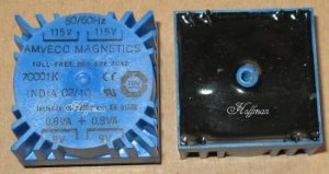

            I used Electro Harmonix 12VAC wall wart and a small tranny from hoffmanamps to make high voltage from 12VAC. It's kind a back to back and heaters from 12VAC.
            Here's the tranny;
            http://www.hoffmanamps.com/MyStore/c...2431_small.jpg
            although it's pretty expensive - 23$
