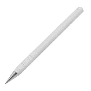

                    Modern idea of what an average soldering iron should be (I'm talking the plain iron, not a soldering station):
                    with the tip being something like:
                    mind you this is a relatively large 40W type, most use the general purpose needle tip, because it's fine for ICs , LEDs, signal transistors, etc. and yet solders well power supply radial cap leads, TO3/TO247 legs, switch and pot legs, etc.
                    But is not enough to heat zinc plated surfaces hot enough for molten flux to "etch" the surface, reduce oxides and facilitate wetting, a most important factor in soldering, because the thermal mass of all but the tiniest metallic parts cools it below that critical temperature ... so you may be forced to *mechanical* surface cleaning.
                    This is what Fender amp builders used (by the way, there was nothing else) and which I also used in the late 60's, the old style 100W soldering iron, with a pinky finger thick bare copper surface ( which we tinned ) and thick flat sided surfaces:
                    look at the tip:
                    pity I can't put these side by side for a better comparison, anyway it's easy to see the way larger contact surface from this flat tip compared to the ubiquitous round one, but the main point is that it's not only a *temperature* problem but a thermal mass and contact surface one.
                    Another difference is that the old tips were tinned (with our own solder) over bare copper , excellent heat transmission, while modern so called "ceramic" ones are actually iron clad .
                    Easy to test, just pick them from the table with a magnet, but iron is a very poor conductor relative to copper.
                    So you can easily solder the old Fender way, both pot bodies and direct to chassis , with an old style 100W iron.
                    Just remember they are too large and hot for PCBs and, most annoying, copper dissolves quickly in solder, so in a short time they show a "caries" just where you need it most.
