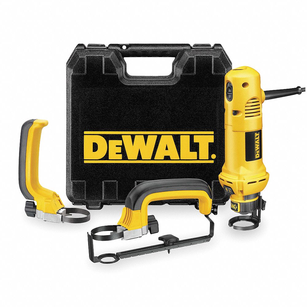

              I've used both routers and jig saws with a piece of string, or wire tied to a center screw with decent results, (I had terrible luck freehand!) A few years ago I found a DeWalt spiral cut saw on the bay with a circle cutting jig, and the last 2 baffles I cut came out great! It's smaller and more easy to maneuver than a router. I found a pic online, but it's been discontinued!
              https://static.grainger.com/rp/s/is/...=1000&wid=1000
