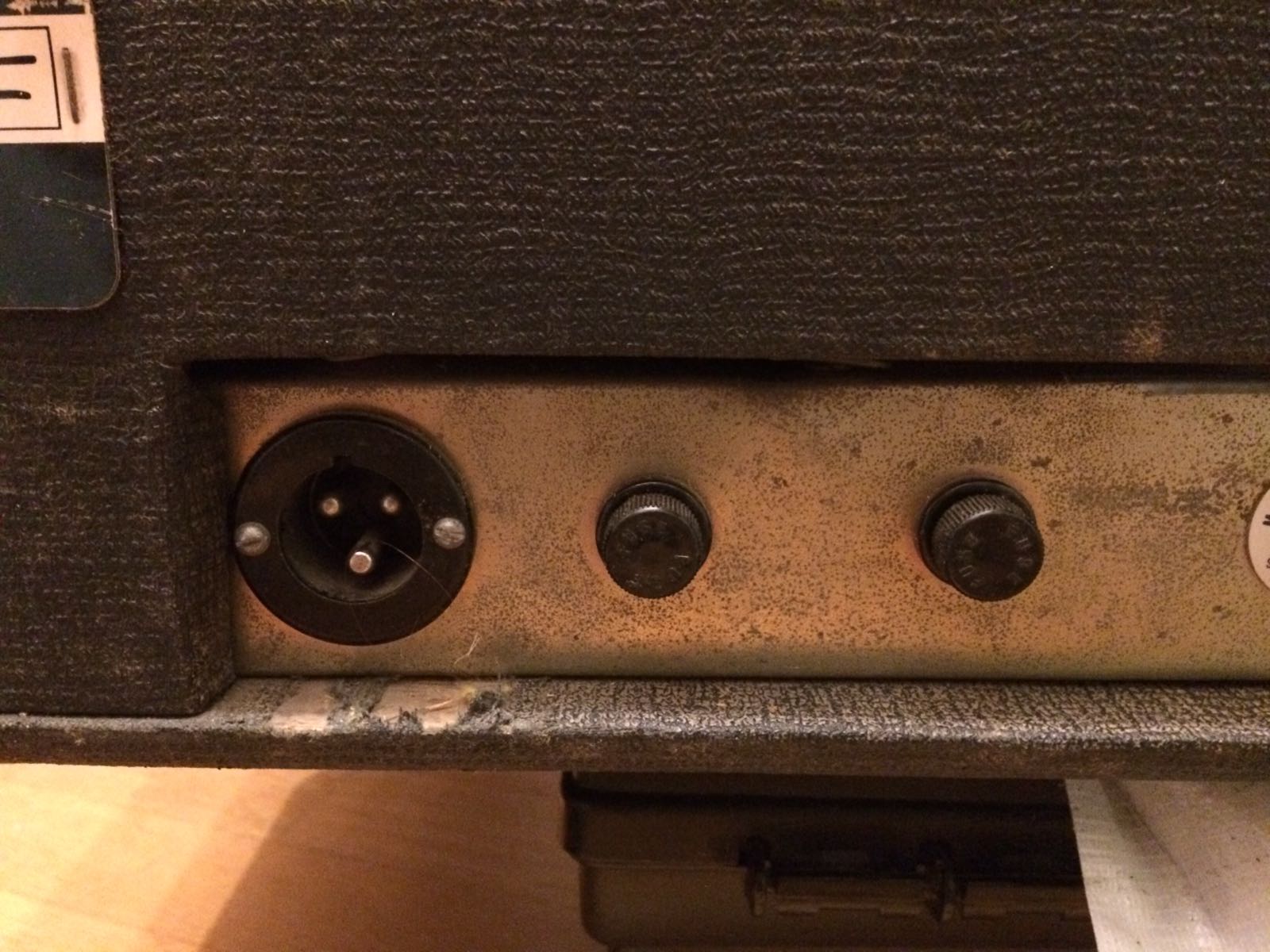

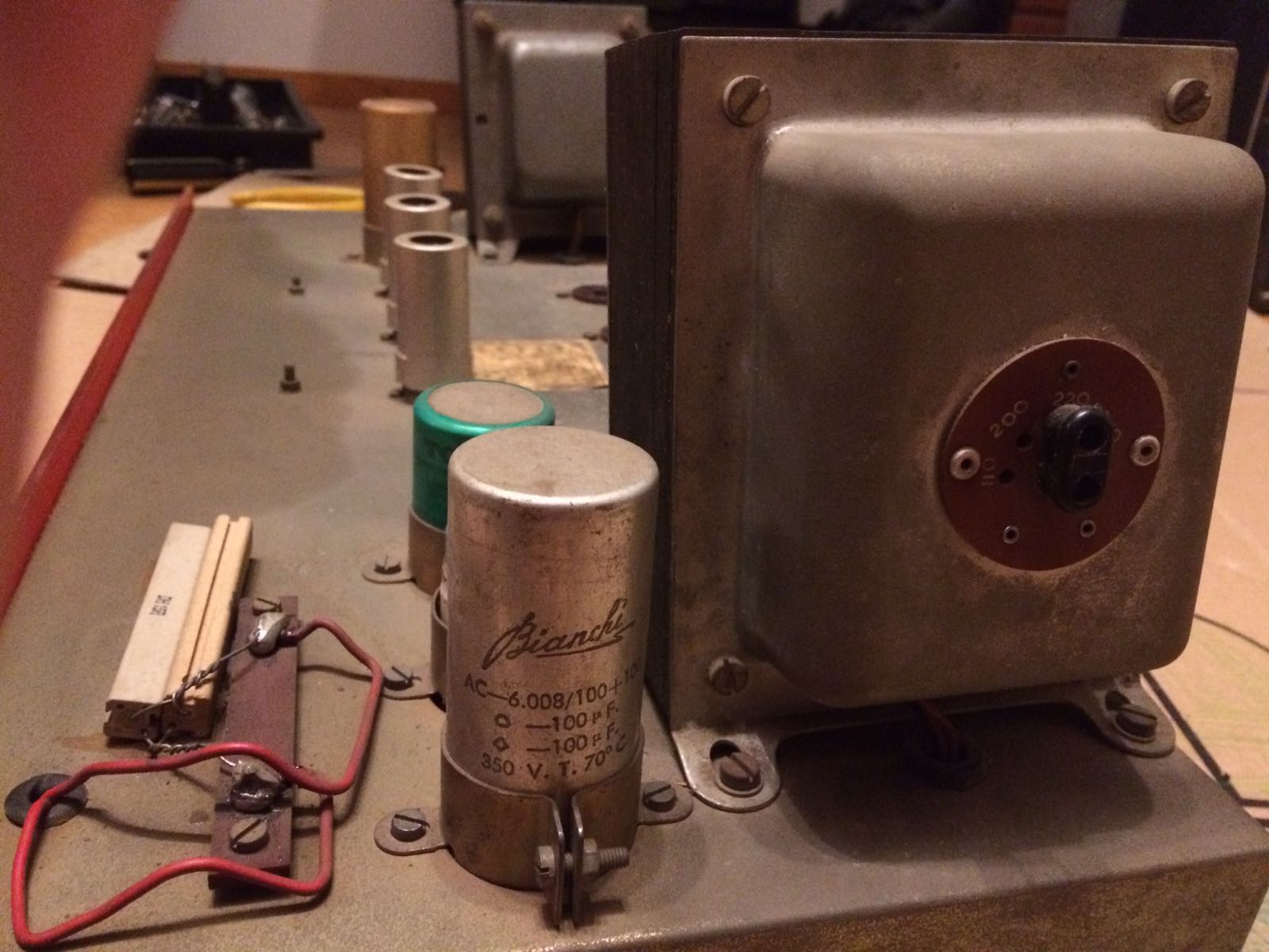

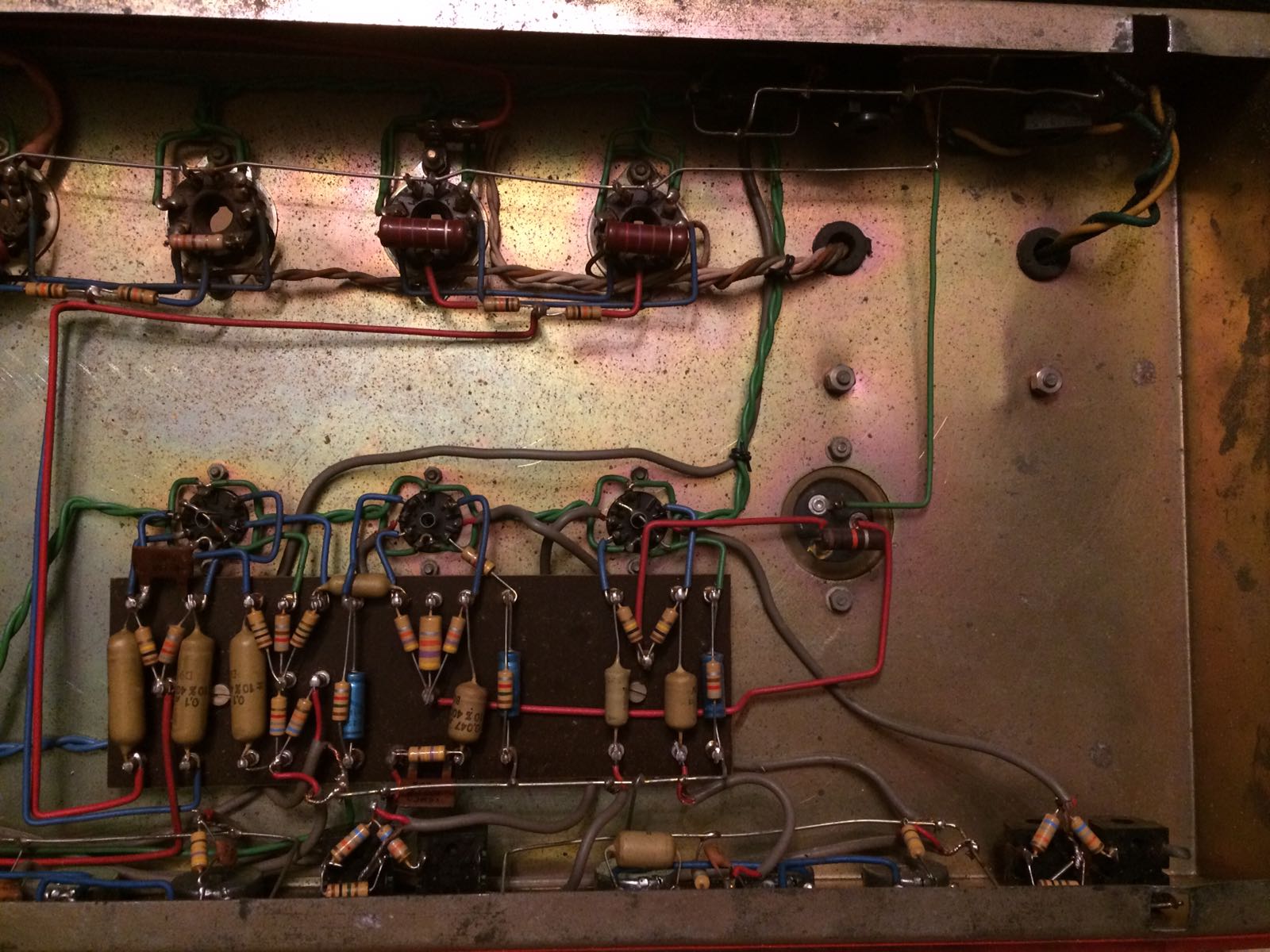

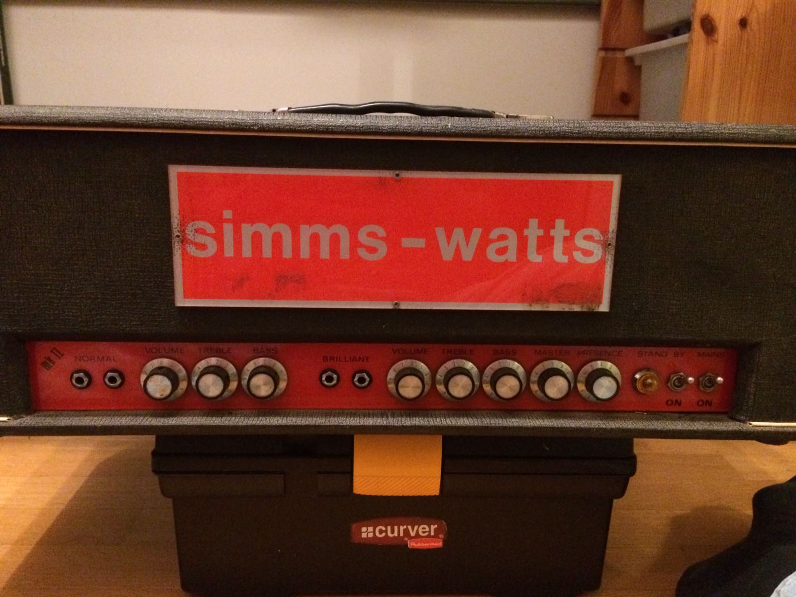

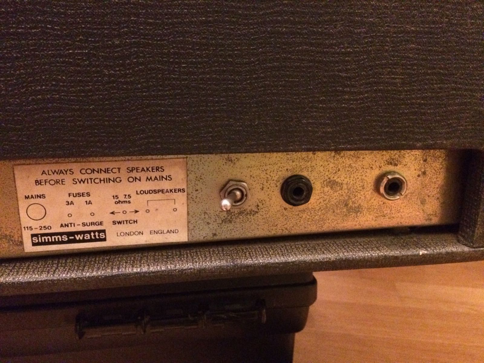

    Hi,
    I last used my Simms Watt 100w Head about 20 years ago. The best is around 48 years old.
    I'm now planning to start it up, and fix it I guess...
    Do you have any advises on how to start it up after so many years out of business?
    I first need to get a mains cable, since I lost it, somewhere in time.
    Here's some pics of the amp.

    I don't have real electronics experience. I can replace simple components and trace them down on the schematics. Last year I managed to bring back to life my old Marshall Valvestate, I just ended up replacing all the main caps of the amp. I hope this doesn't get much more complex though.
    Any hints or suggestions are welcome.

    You should build a light bulb limiter to plug it into when you first start it up. It will prevent and serious damage in case any components have failed.
    Originally posted by Enzo
    I have a sign in my shop that says, "Never think up reasons not to check something."
      Well... What I see is that somewhere along the line someone (probably on more than one occasion) kludged that amp with an odd assortment of filter caps (one of which is axial instead of radial) and added a series resistor to the B+ string after the standby switch putting exposed high voltage nodes within reach of the user from outside of the amp. All I can say is that this is a very bad thing that can result in death if such an accident were to happen. Soooooo...
      I would undo that stuff for certain. On the other hand, if the amp worked for you the last time you used it, you have had no trouble and liked the amp as it was then there is the probability that removing the HV rail resistor will change the response of the amp a little. But at the very least that resistor should be mounted on a terminal strip INSIDE the chassis and that axial lead HV capacitor should be replaced with a radial capacitor.
      But I suspect all the electrolytic caps will need to be replaced due to age and disuse. Twenty idle years will kill most electrolytic caps. As g1 said (and if you're comfortable with the dangers I noted) you can bring the amp up on a limiter for a few hours and the caps may survive. Though they may not perform well and you would experience extra noise, hum and odd harmonic overtones.
      "Take two placebos, works twice as well." Enzo
      "Now get off my lawn with your silicooties and boom-chucka speakers and computers masquerading as amplifiers" Justin Thomas
      "If you're not interested in opinions and the experience of others, why even start a thread?
      You can't just expect consent." Helmholtz

        When I worked on the Valvestate I paid extra attention to discharging big caps and so. And this one looks much more scary. I'll definitely check the light bulb limiter stuff.
        Yeah those resistors were mounted by a "professional" many years ago, the amp worked fine after that. But I'll follow your advice and at least move them to the inside. If I knew what was the original setup of those resistors I would try to get them close to those.
        Unfortunately I don't have complete schematics. I guess all I have is this: https://drtube.com/schematics/simms/100w-amp.gif
        Regarding that axial lead HV capacitor. Could you please point out which one you mean, on which pic?
        Yep, I understand the caps aging. Lets see if I can carefully bring it up and see what comes out of the amp.

          picture 9 it's the blue one. The negative lead is sticking up outside of the chassis and a wire goes back into the chassis to connect to ground inside the amp
            Originally posted by josegrad View Post
            UPDATE: Actually, I've seen now a few more pictures of that amp, and all seem to have the resistor on the outside:
            Well looky there! Ok... Not how I would have done it. A bit dangerous and you sure couldn't design the amp like that today. But I should have looked for myself before critiquing. The grommet sort of hinted that it might be a stock installation, but I thought "No way anyone chose to sell the amp new like that." I was wrong.
            NBD on mounting the axial cap with the ground lead sticking out of the chassis. There's no HV on that lead. I've done sort of the opposite mounting radial caps on boards made for axial caps. The amp doesn't know the difference

              Hi there,

              But I'm not sure which part is that area on the left that says "3x1AT". Where is that located?
              On the other hand I just got a Bulgin connector from the UK.
              In the attached image you can see how the power connector is connected inside the amp. With a Red, Green and Black cable.
              Then there's the cable I'll use with Blue, Brown and Yellow/Green.
              If I'm not mistaken the cables should end up like in the table below.
              I'll appreciate any corrections obviously.

              • #8
                It looks like a mod to add three 1A T fuses to the standby switch area. I think the fuse marked with an 'X' is to go in series with the bias winding where it's marked with a second 'X'
                The wire colour table is correct.
