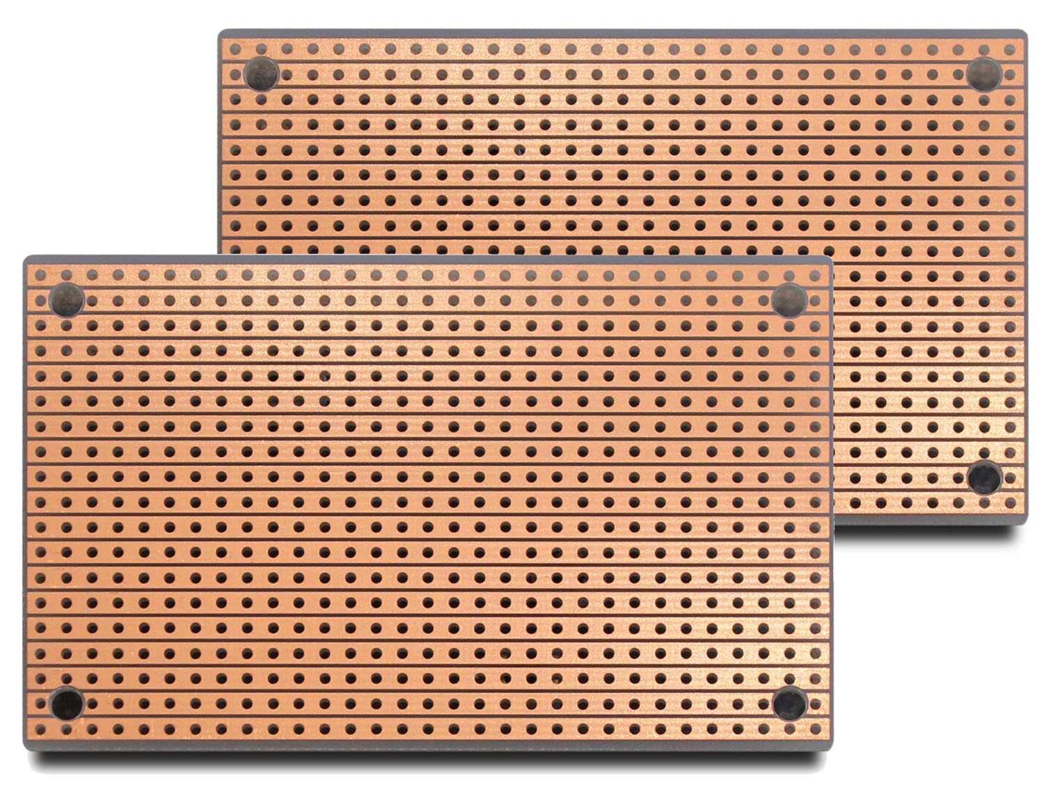

    I finally got around to ordering some stripboards in 2 different sizes for FX pedal projects. Making or buying pcb's for projects has always been the issue for me. When I was building all of the Craig Anderton projects 30 years ago I would trace out his layout drawings on clear acetate sheets, punching holes for the copper pads and then copying them onto copper-clad pcb blanks using acid-resist pens, et al. What a hassle! I tried photo-resist boards a few times- even built an UV light rig- but they never came out very well.
    Perfboard is great for prototypes - or Trainwreck guitar amps - but pretty much not ready for primetime. I used a lot of the Radio Shack DIP IC pcbs for relay boards for guitar amps but they were very limited.
    Enter Vero stripboards, a real game changer, especially for the sharing of designs. No need for a precise drawing of the board layout to be copied one way or another. I consider the concept to be potentionally as revolutionary as BASIC was to PC programming back in the 80s. I guess that it was with arduinos that they became really popular with DIYers but I learned that they were introduced in the UK in the early 60s.
    Here is a link to one site with a lot of stripboard "maps" for FX projects, hopefully the first link of many in this thread. BTW you can use a handheld drill bit to cut the continuous strips.

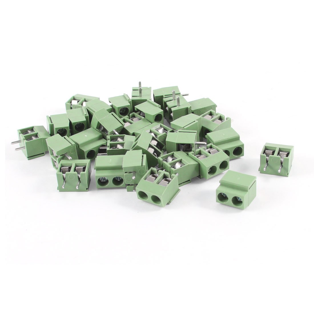

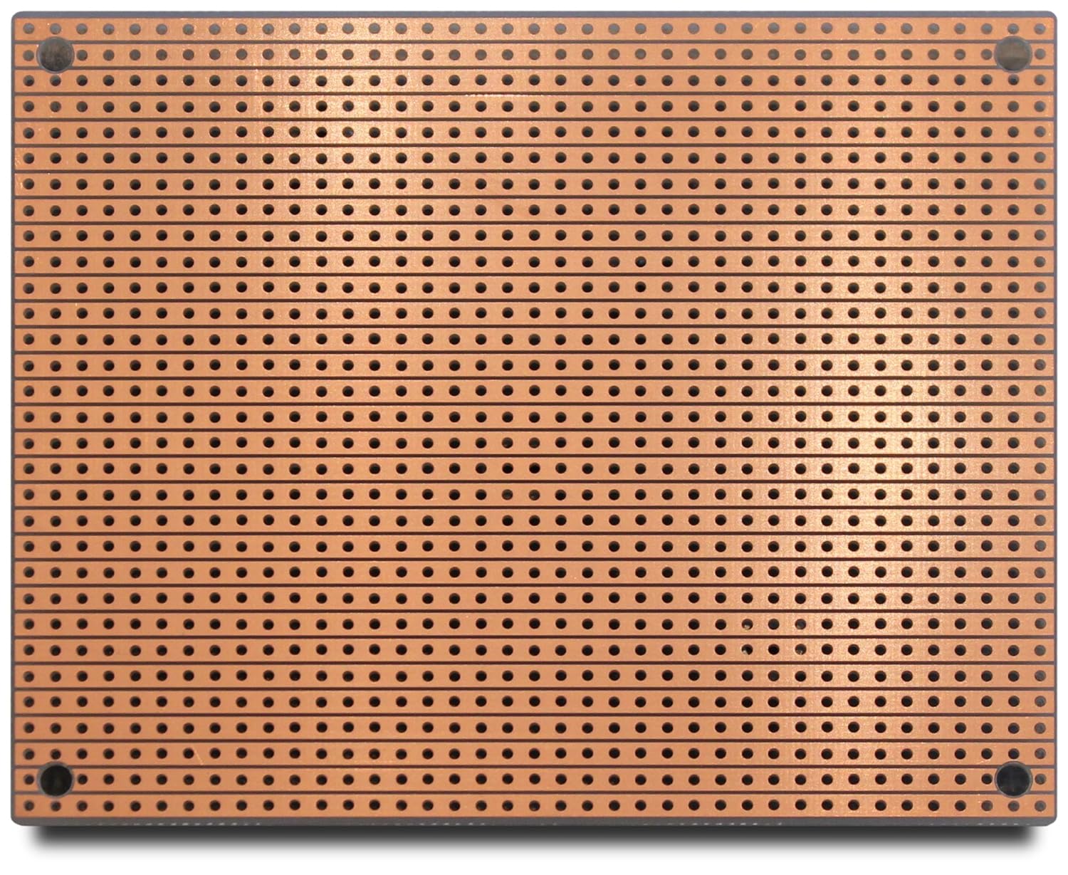

    Here are links to the two sizes of stripboards I just ordered from Amazon along with some 2 pin PCB terminal blocks to attach flying leads.
    http://www.amazon.com/gp/product/B00PBGFD5A
    ST2 StripBoard, Uncut Strips, 1 Sided PCB, Size 2 = 100 x 80mm (3.94 x 3.15in): Amazon.com: Industrial & Scientific
    Amazon.com: 30Pcs 2 Pole 5mm Pitch PCB Mount Screw Terminal Block 8A 250V: Computers & Accessories
