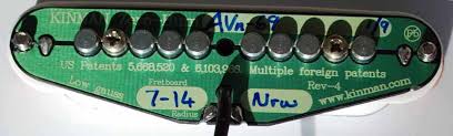

            More Information for Telecaster
            On Kinman's Strat pickups, he also adds the extra slugs to the bottom coil:

                Originally posted by Mike Sulzer View Post
                But this is no surprise: the purpose of a patent is to protect your idea without actually revealing how it works.
                Except it does work, and it's not hard to see what they did when looking at an actual pickup, and not the patent. The patent might be vague, but the pickup isn't. I did some experimenting on a similar setup and it was easy to get it to work. The higher inductance is in the bottom coil which doesn't sense the strings, just the noise.
                The Kevin Beller version is interesting.

                                I think the Kinman and Beller versions sum up the idea pretty well. DiMarzio took Kinman's original idea and used two of their previous patents combined to arrive at the same thing.
