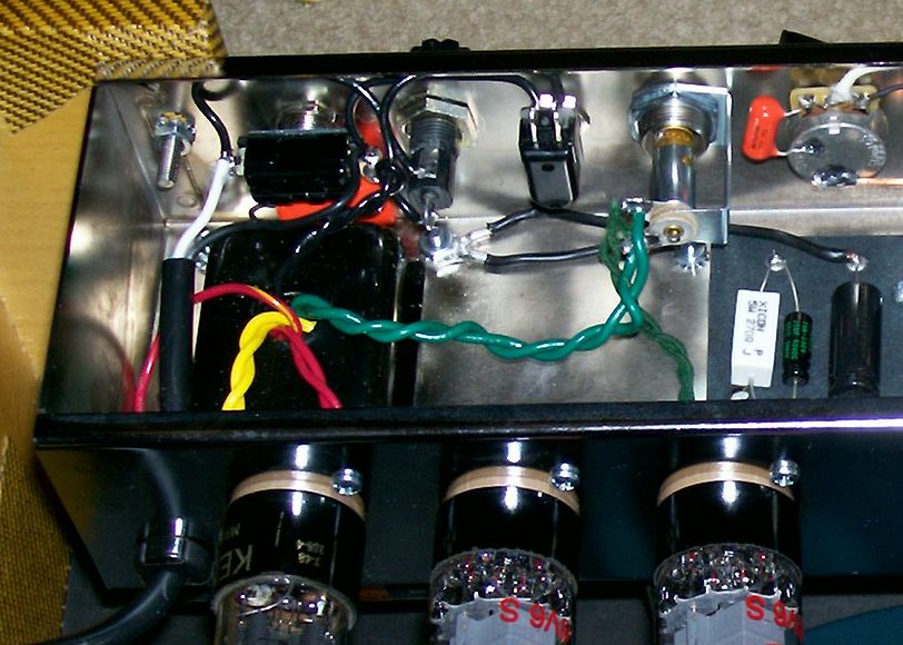

I just finished building my first 5E3 kit, and it's the first time I've played a 5E3. After reading lots about grounding and all the methods and varying (and sometimes conflicting) opinions, I did exactly as described above.
My amp, however, has a bit of 60 cycle hum that follows the volume control. At low volumes, it's practically inaudible. When the volume is up high, it's more noticeable. It's higher on the Normal channel than the Bright channel. I tried a couple of quick mods to see if I could alter it: (a) I tried moving the back-of-pot ground buss chassis tie from the jack side to the PT side, and (b) I tried a shielded audio cable (ground on one side) from the first volume pot to V2. In both cases, there was no distinguishable change to the hum.
So now I'm curious: how can I totally get rid of the 60 cycle hum?

Steve nailed it. Grounding is truely a Black Art Light the incense!
In ideal point to "jump grounds", going from the quiet preamp ground to the noisey output stage ground is where the signal is differential. At that point the push pull power tubes can reject the ground noise, it cancels at the output transformer. The power tube grid leak resistors can be "grounded" at either ground without much penality. In fixed biased amps, the bias supply ground performs that function with the added aggravation of the rectifier currents. Probably best to keep those currents with the power stage ground and not pass them between grounds.
mbratch: 60Hz hums usually come from lead dress or heater supply issues. 120Hz buzz type hums are usually ground related. Try a hum-balance control and/or elevating the heater supply.

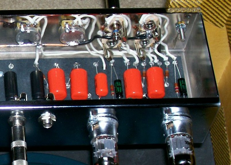

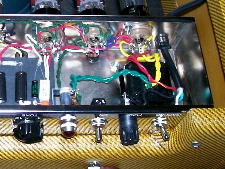

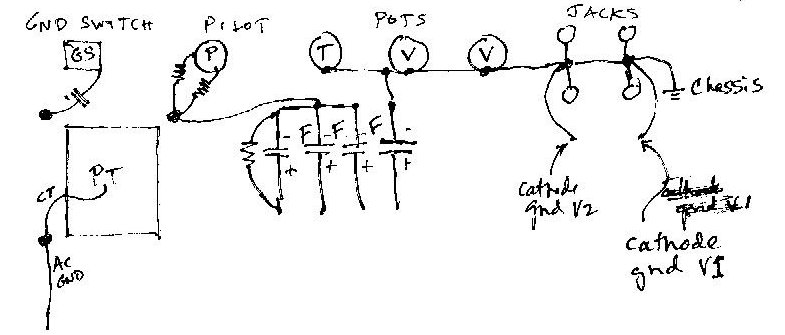

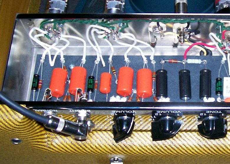

Interesting, after my amp has warmed up a bit, the 60 (or 120?) Hz sound subsides a bit. It's almost inaudible unless you are listening hard or the amp is turned up to nearly 12 on the volume. But, I've heard a couple people now say their amps are "dead quiet" so I am striving for that! It must be entering at the input stage somewhere, as it is controllable from the volume controls. If either volume control goes up, so does the hum. No volume, no hum.
I have some pics now of what my amp guts look like. First, is a quick drawn layout of where the grounds are, then the actual pics:

So theoretically all the ground points I show in my diagram look OK a-la Hoffman?
I just made a change to bring the crossing heater wire through the middle of the socket, arched, so there is no more crossing. I did the same with both V1 and V2. I made the heater wires more direct from pilot light to the first power tube as well to avoid being around the OT wires.
Still the hum.
I had previously moved those white wires around everywhere, up and out of the way, and it didn't change the hum.
I did notice a very slight hum, but definite, when both volumes are down at minimum. When I touch the chassis, it goes away. Not sure what that means...
mbratch is offline   Reply With Quote

Since the hum is still there without the guitar cable plugged in, it is related to grounding.
Your body acts as a large low reservoir capacitor when you touch the amp chassis, diverting the residual low-voltage swing in the chassis to ground reducing the hum. The hum is caused by localised micro rises in ground potential in different parts of the ground return path interacting with 'lesser' potentials - inducing an unwanted AC into the signal path.
You need to re-do the grounding first. I recommend a split-ground system (works for me)
I have all the pre-amp ground return paths going each by their own individual separate wire to one common chassis point (which I make at one of the input socket grounds). I include the pre-amp filter cap ground return with these.
I have the output stage ground returns, including the screen and reservoir filter cap grounds, and the HT CT and Heater CT going by their own separate wires to one of the PT bolts at the other end of the chassis.
My grounding system is sort of split. I have all the power stuff going to one side, and the pre-amp stuff to the other (via the buss on the back of the pots). In your case then, instead of a buss, you are doing a star ground back to one input jack? Where do you run the grounds from the pots, to the same star location on the jack side? Is that jack then grounded to the chassis directly near by?
Is it necessary that the CTs, filter cap grounds go to the same PT bolt? Should the AC ground go to a separate one or the same one?
BTW the system I used fits one of the other members' scheme descriptions perfectly and theirs does not hum. :-/

Is the first tube a 12AX7 or 12AY7 ? Comparing your ground diagram to the Fender, I noticed the middle filter cap goes to the main filter on yours and the preamp filter on Leo's. Which one is right? The one that makes the quietest amp. The second thing I noticed was the virtual center tap going to ground. Try moving it to the high side of the output stage cathode resistor. That will sometimes get rid of a small amount of 60Hz hum.
Good catch. The one I did is what the Fender Deluxe reissue uses. I can change it to the older, Leo method and see what happens. But I wasn't sure since the rest of my grounding isn't like Leo's either. It would be easy for me to flip it back around and see what happens.
OK, I'll give that a shot. I did see that on a one Deluxe layout somewhere (perhaps Mission?).
