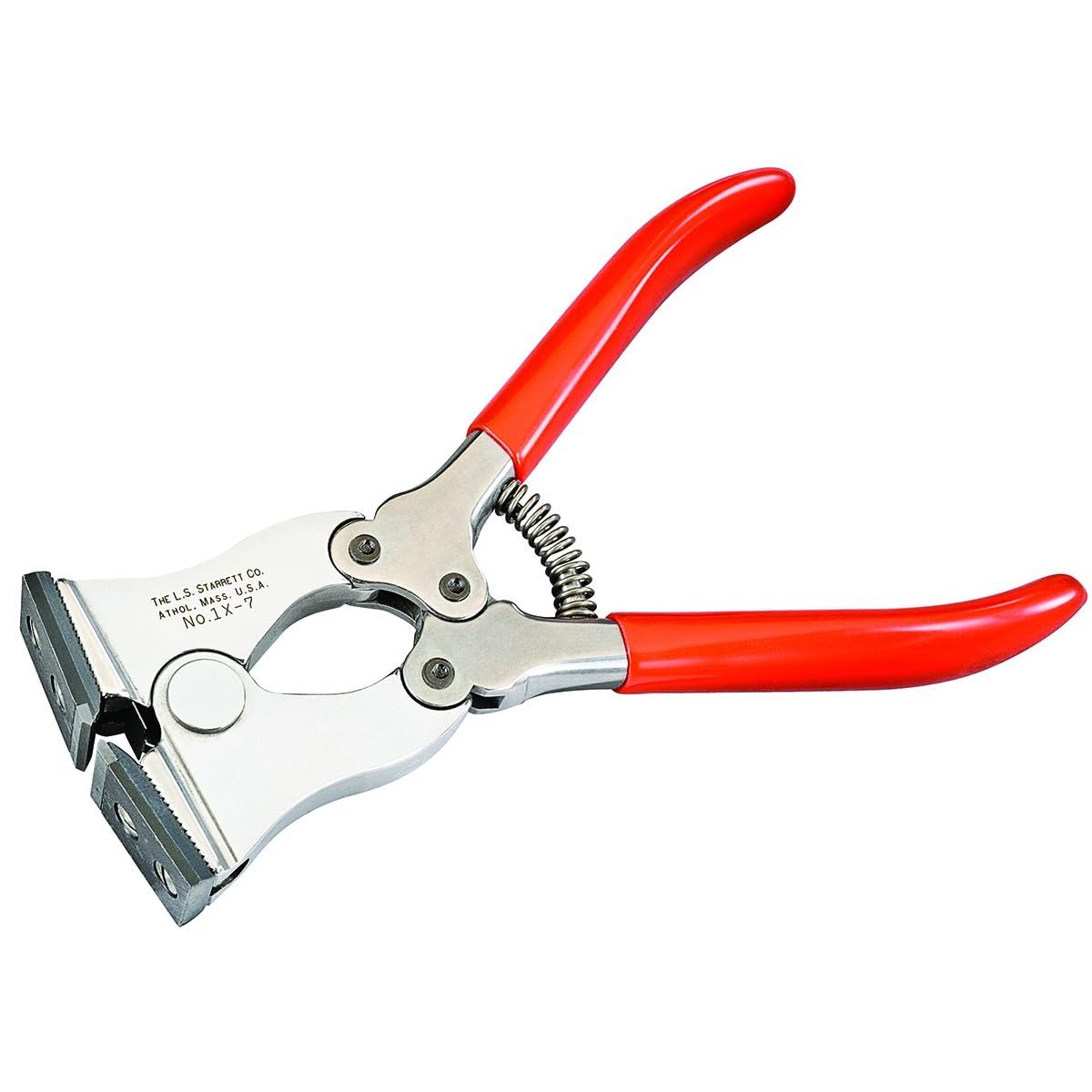

    333
    tonequester here.
    It gets old ruining tools. Ive never found regular cutters that stand up to the hardness of steel strings. You mention getting close to the tuning peg, so I take it you're talking about cutting the excess string off after installation of a new set. Believe it or not, gripping the string by hand, or if remnent is not long enough, by pliers, one can use a Dremel tool with a small common aluminum oxide grinding bit, it works well, and the special cutting disks work even better. One does need to take some care, but it works a lot smoother than you might think. Just a light touch is all that's needed. If one uses a cutting disk, use the fiber impregnated ones, not the shatter prone/easily broken kind.
    Every set of cutters I've ever tried to cut strings with,have been quickly damaged, and became useless over time. Just a suggestion. Best Wishes Steve. tonequester.

    Posts
    41
    Wire cutters are designed and sold for cutting copper and aluminum, to be price competitive they use steel that is correct for that job. You can buy "Cable Shears" that will be rated for steel. I have some that were made for bike brake cables that work great on the bench but I just use the $3 harbor freight diag cutters in my guitar case.
